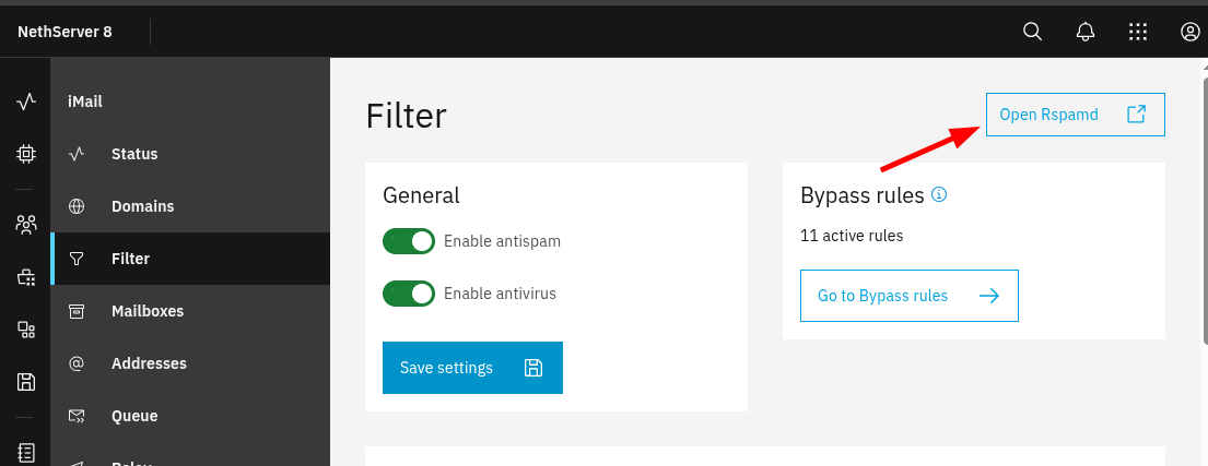

To verify that this is the issue, open the Rspamd web interface. On NethServer 8 you can also reach it from the mail server filter settings in cluster-admin.
Rspamd shortcut in cluster-admin
note
Use the same credentials you use to log in to cluster-admin.

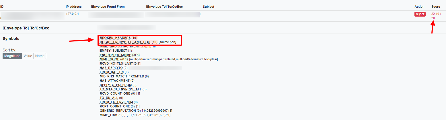

Open the History tab to inspect the score assigned to each message.
Rspamd History tab
When this problem occurs, the affected messages usually contain these two symbols:
  • BOGUS_ENCRYPTED_AND_TEXT (10)
  • BROKEN_HEADERS (10)
Because they add 10 + 10 points, they can easily exceed the rejection threshold and trigger the Reject action.
Message rejected because of score

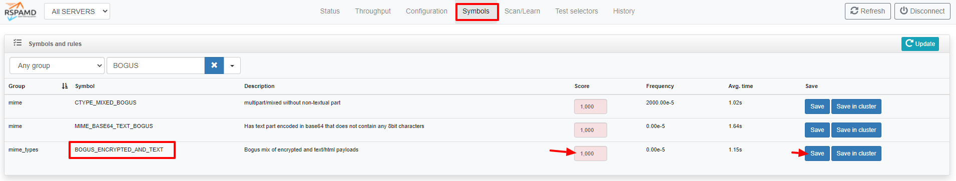

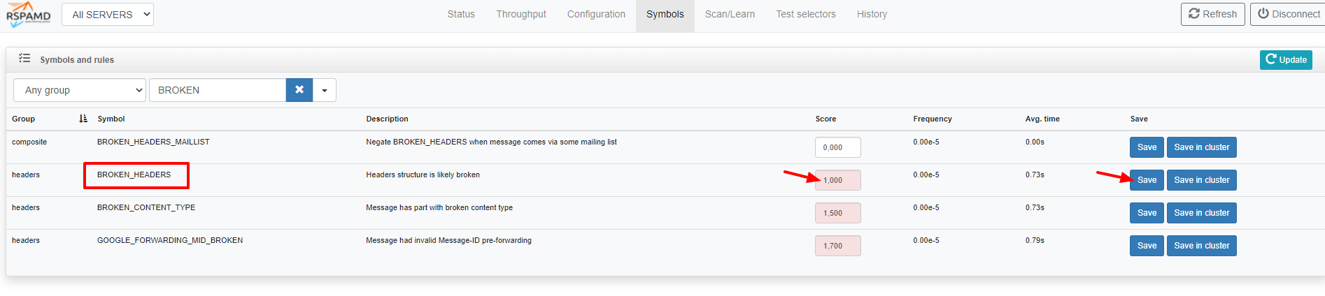

Lower the score of both symbols from 10 to 1.
You can change them from the Symbols tab in the Rspamd web interface. Use the search box with the BOGUS and BROKEN keys to find the symbols.
Search symbols in Rspamd
Lower the symbol scores
After saving the new values, no additional action is required. Subsequent messages containing this type of signed attachment are received or sent normally.
